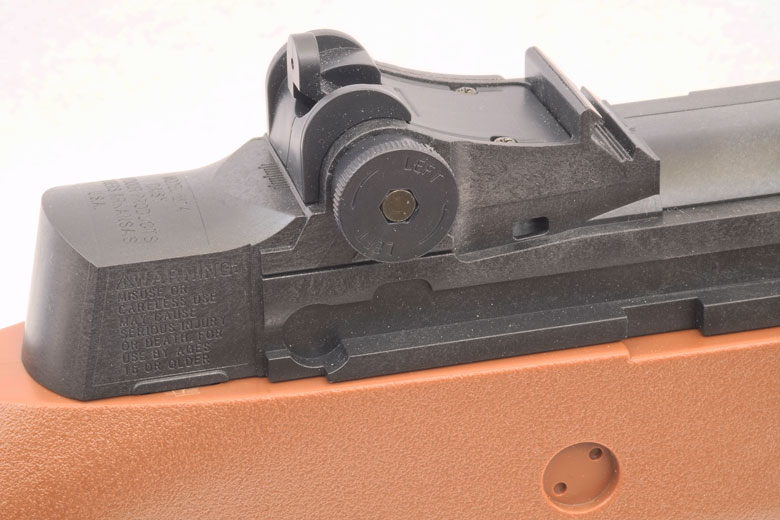

SIGHTS AND SCOPE
The Winchester M14 CO2 air rifle is really an open sights only air rifle.
The open sights of the Winchester M14 CO2 air rifle are quite similar to those of the original firearm. There’s a front post, combined with an aperture rear sight that is easily adjustable for both windage and elevation.
Winchester M14 CO2 Air Rifle Test Review
The front post has protecting “ears”, just like the firearm it copies. The rear sights are click-adjustable for elevation and windage. Again, the appearance and function of the rear sight is very close to that of the original M14. The left side knob controls the elevation and rotates against a simple click system. The right knob adjusts windage and – again like the firearm – rotates in quarter turn increments, needing to be pulled out slightly in order to make the adjustment.
These sights work well at close range and the HAM test team was happy with the sight picture and usability out to 20 yards with soda can-size targets.
The action of the Winchester M14 CO2 air rifle is – again like the firearm original – less than ideal for scope mounting. The HAM team is not aware of a scope mount ever having been produced for this air rifle, but it’s clear that someone once thought that it would…
Just in front of the rear sight assembly, there’s a molded plastic dovetail running at right angles to the bore. And further forward on the left of the receiver, there’s a hole through the plastic exterior molding to a tapped hole in a metal part of the breech. It’s actually tapped for a metric M4 screw. Above it is a molded vertical locating slot.
Again, this “dovetail and screw” scope mounting system replicates that of the original M14 firearm very precisely. (Well, except for the diameter of the screw hole!).
Given this attention to detail, it’s disappointing that a scope mount has never been made available for the Winchester M14 CO2 air rifle.
But, the accuracy level demonstrated by the Winchester M14 CO2 air rifle tested by HAM suggests that a scope would not be an useful addition, even if it could be fitted.
